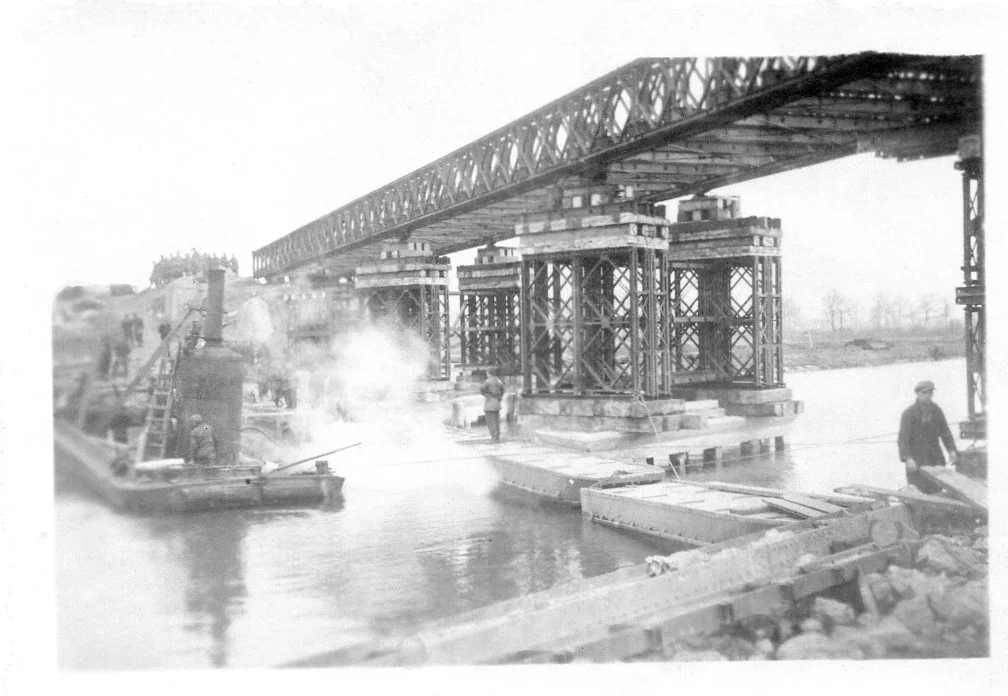

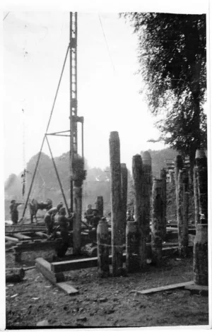

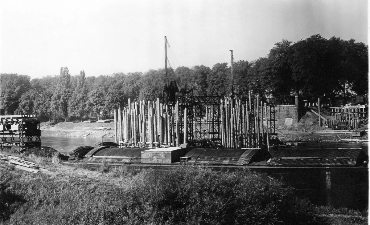

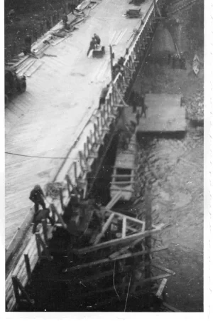

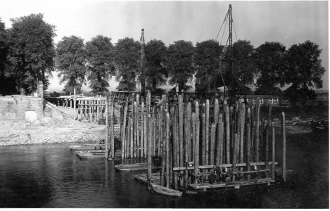

I have to try to make sense of the sequence of events in the building of this bridge 70 years later. The document above is dated but I cant figure out when it arrives in the times of the archive. Some pictures are annotateded by my father on the reverse but I will try to make some order of it and as I add scans I will put my comments at the top and his notes underneath the photos. I assume you can't do the job at all unless you have the piling in place so that comes first in the series. He mentions a piling rig "HMS Topheavy" so although the first pic is a little out of sequence he names the rig and you can see the canvas cover it has and also identify the rig in later pictures. This one is a 17 x 23 cm print. It must have been taken from the centre of the bridge before the middle section was added to complete the span.
Packing on to which spans were launched,
Some pier details
on left, "HMS Topheavy", piling rig
Two postcard size pictures. The one with the pile driver on it has no notes . The line of planted trees is a good reference point in the pictures

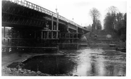

Neinberg piers from East Bank

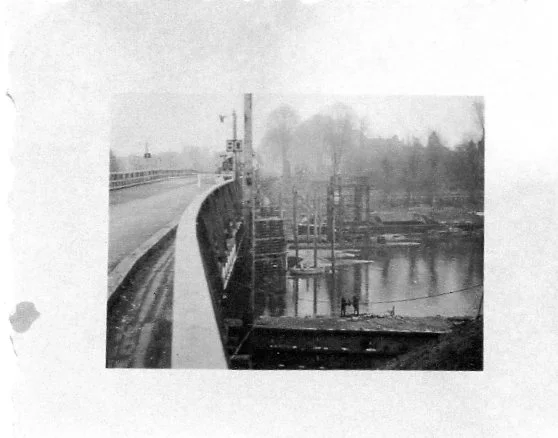

The second one is a contact print and even more interesting as you can see "Anniversary Bridge" down stream and I was wrong before, it is a single track road bridge.

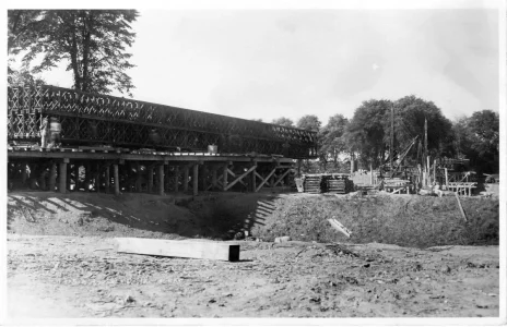

Neinberg East Timber approach

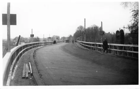

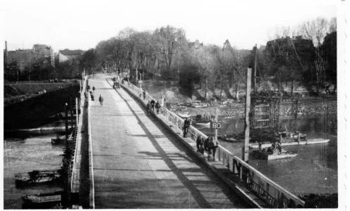

The final pictures at present are the bridge in use.
A. 1/3 of Camp Bridge
Neinberg looking East
West end
